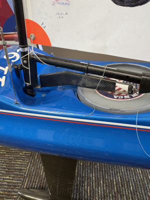

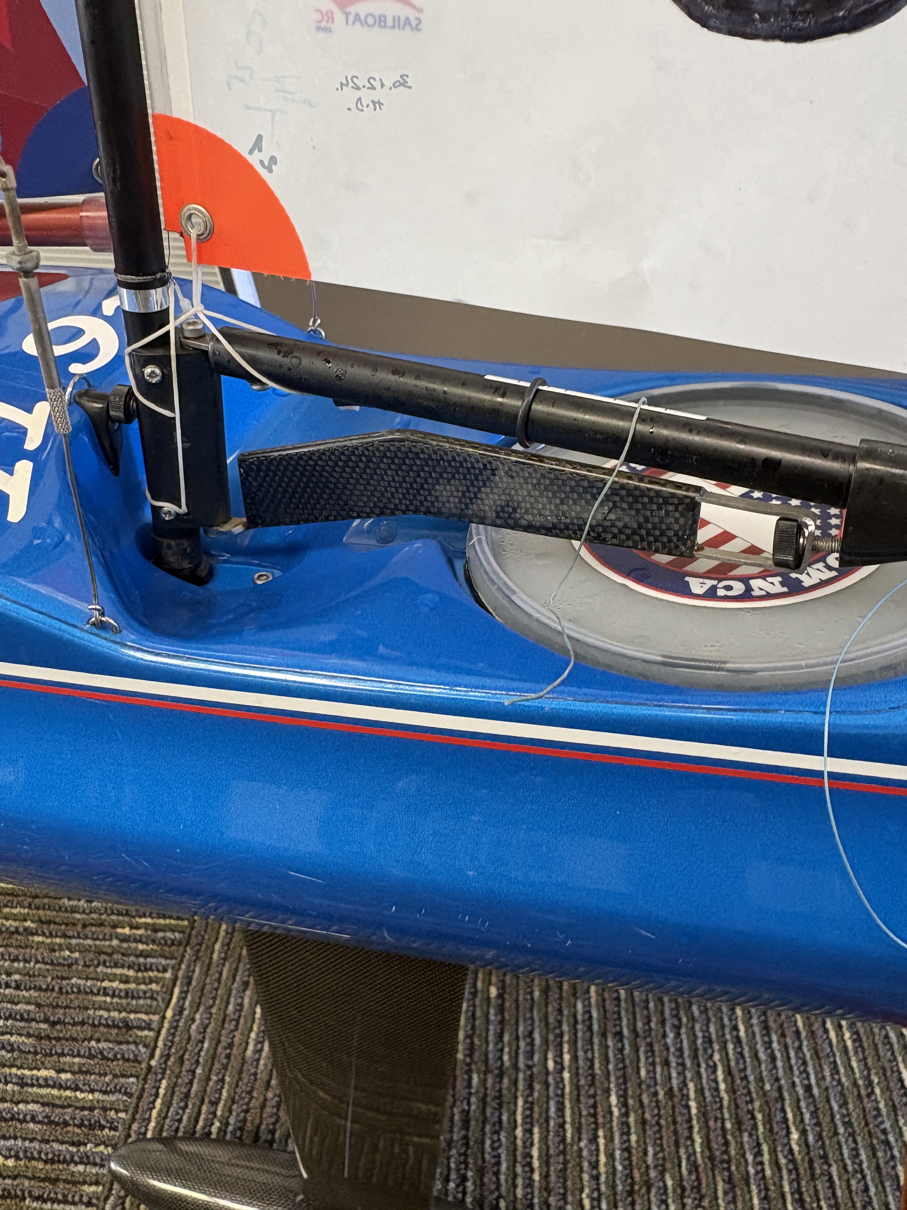

Jerry Brower
- Posts: 7
- Joined: 20 Sep 2010, 00:44
- Sail number: USA 26
- Club: Anacortes RCS
- Design: VISS
- Location: Lake Stevens, WA
Myself being one known too many times to have wrench in hand and aimed squarely at The Mix, I offer this boom vang cam plate design that could possibly be older than the IOM class. It definitely fits well within the build on the kitchen table at minimal cost philosophy that spawned the IOM class. I wonder how this configuration would fit through the ring gauge restrictions suggested for previous rule suggestions. As an aside, note the clear window of cellulose acetate used to likely increase sail area. The transparent plate tied below the main boom is nearly invisible to all but the most diligent observer.
Cool design
Should be OK now, now that multiple attachment points are allowed.

Hi Jerry, thanks for this. I assume it did not pass the ring gauge test when that was a part of the rules in 2024? Something else to think about for sure.

Andrew - sorry to bother again but;
A.1.4 DEFINITIONS
Vang - Equipment connected to the boom and used to control the angle between the mast and the boom.
How do we determine what constitutes the "vang" and what constitutes the "vang fitting"? In our own definition we make no distinction between the two inasmuch the term "vang" includes everything that controls boom angle.
A.1.4 DEFINITIONS
In my personal capacity without association with IRSA
- Vice-chairman (Technical)
- Posts: 150
- Joined: 19 Dec 2025, 21:45
- Sail number: AUS 36
- Club: Albert Park Model Yacht Club
- Design: Blitz 6
- Location: Melbourne, Australia
Hi Bruce,
Thanks for the question. I feel that the reasoning is as follows:
- 1. A vang is a part of the running rigging (ERS F.1.7(b)(xi), in turn, a part of the rigging.
- 2. Rigging “… includes associated fittings which are not permanently fixed to a hull, spar, or spreader (ERS F.1.6)” – my emphasis.
- 3. By implication of (2) above, a fitting that is permanently fixed to a spar is not a part of the rigging and, therefore, not a part of the vang (as an item of running rigging).
- 4. Therefore, the fitting that is fixed to the mast upon which the vang pivots is the vang fitting and not the vang .
- 5. The statement at (4) becomes more complicated when the vang fitting and gooseneck are combined (particularly if the gooseneck pivots) but I believe the principle is the same as the fitting normally fixed to the mast is now fixed to the gooseneck that is, turn, fixed to the mast.
- 6. At the boom end, the vang may either be connected to a fitting that is fixed to the boom or, in some arrangements, attached via an opening (both permitted under the class rules). If it is a fitting fixed to the boom, it is also not a part of the vang but is, rather, a vang fitting.
- Posts: 811
- Joined: 25 Nov 2003, 00:06
- Sail number: USA 16
- Club: Famous Potatoes Sailing Club
- Design: Brit Pop
- Location: Boise, Idaho
Thanks for taking the time to respond. Would be easier in person over a pint.
Your logic maks sense although now we must define what "permanently fixed" means. Are fittings that are screwed into or threaded onto permanent?
- Posts: 150
- Design: Blitz 6
Hi Bruce, I have to say that I focus more on the word "fixed" - i.e., immovable in normal circumstances. Screwed to the mast, stuck to the mast, pinned to the mast, clamped to the mast, are all "fixed". As opposed to moving/rotating/etc. I am sure it is frustrating for all that the class rules become more akin to tax law with the same requirement for trained personnel to accurately understand their meaning. Yet it is hard to see an alternative path at present. Regards, Andrew
