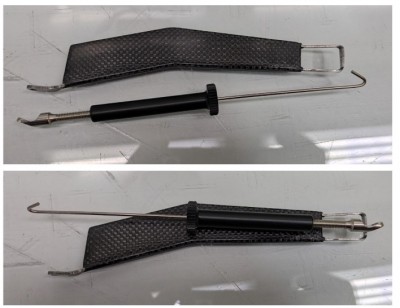

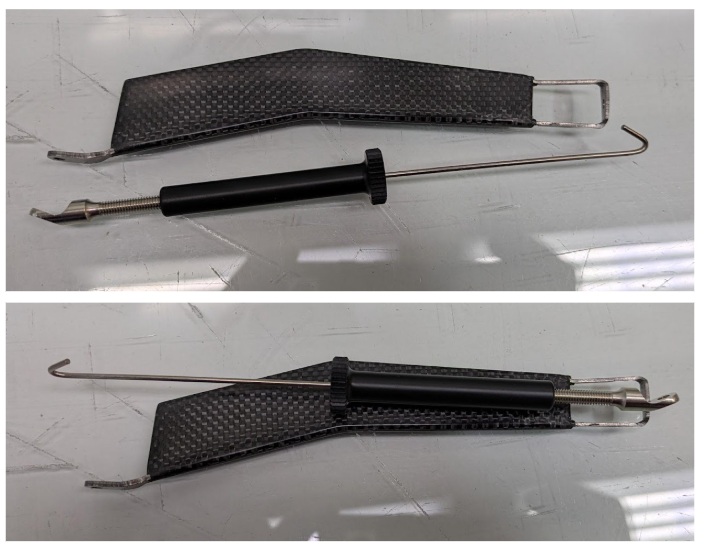

Hi Art, thanks for your thoughts.
In referencing the definition of “closed class rules”, you raise a very interesting point. The IOM Class Rules note at the outset that “… anything not specifically permitted by the class rules is prohibited. Individual rules may require, limit, or permit as necessary”. Given that, consider these three examples:
- A mainsail boom. It is specifically permitted (F.1.1(b)), and it is extensively and explicitly limited (F.4, C.8.3(b)(1)). A builder can be in little doubt as to what is required to comply with Class Rules, provided they read them carefully,
- Headsail swivel inside a tube (this topic is the subject of the Q&A "Is it permitted to have headsail swivel inside the watertight tube?”). The Class Rules do not "specifically permit" a "headsail swivel inside a tube” in the sense that these words do not appear anywhere in the Class Rules. As a result, a builder contemplating such a construction would be wise to seek clarification (and did so). The answer to the question was that the combination of Class Rules relating to a “headsail swivel” (F.4.4(a)(3), F.5.2(a)(2), C.7.5, F.2.4(c)) indeed permit such an arrangement - a headsail swivel is permitted, but the limitations do not rule out it being in a tube.
- The vang. It is specifically permitted (F.6.2(a)(2)) but not explicitly limited by any rule. Where an item is explicitly permitted but not explicitly restricted, what clarification is a builder seeking?

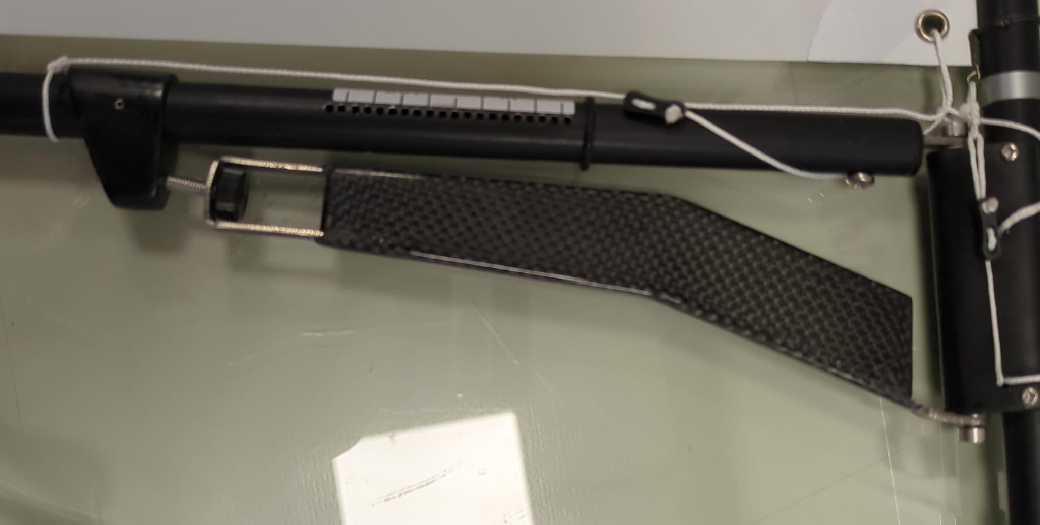

Hello everyone, in my humble opinion as a boat designer, limiting the vang area on modern boats no longer makes much sense. Most of us have a cockpit that's recessed into the deck, and we try to lower the rigging's center of gravity as much as possible. Therefore, the surface area projected outside the cockpit by a large vang wouldn't, in my opinion, have a significant propulsive effect, contrary to what some might believe. Making a vang that extends to the end of the boom to increase projected surface area, as mentioned above, also wouldn't make much sense to me, since I prefer to lower the mast and have the boom just touch the deck. On more classic boats where the mast is higher and there weren't cockpits to lower the mast's center of gravity, I could understand this debate. Perhaps I'm wrong and not analyzing this issue correctly, but according to my understanding, this is my point of view...

Thanks for being open to public discussion on this controversial topic. Opening up this forum is a step in the right direction. Social media is nice for photos etc but does not offer much in terms of keeping a substantive discussion in one place.
I fear that unless we clearly define the maximum surface area of the vang and its associated mast & boom fittings, some will continue to push this particular envelope.
Regardless of opinions advanced proposing that the added projected area is inconsequential, it does exist and does add some (albeit small) area to the sail plan.
Why not attach a plate vang to the distal end of the boom, thus adding even more projected area?
The requirement for the vang to "fit" through a 20 mm ring gauge is also troublesome - what would stop someone from creating an elastomeric sheet that hung off the bottom of the vang to completely close off the gap between the deck and the lower edge of the vang, then simply roll it up to fit through the ring gauge? Is this the true purpose of a boom vang?
Why not simply limit the vang to a reasonably small attachment to the mast and a similarly reasonably small wire /turnbuckle or line/bowsie attachment to the boom as has been traditionally used for many years?

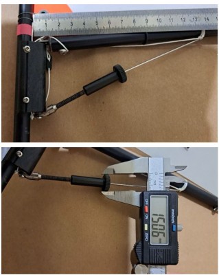

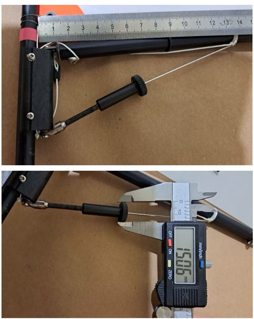

Dear
The surface area of the Viss Vang is 1739 sq mm, and can be seen at the following link: viewtopic.php?f=7&t=2111
This is a comparison with a vang that has been on the market for a long time, so I assume that it does not violate Rule F.2.3, and that our solution is therefore compliant with the rules as well.
The key question, in my view, is who determines whether Rule F.2.3 is being violated, and how the limit of Rule F.2.3 is actually defined.
To resolve this issue clearly and ensure that all existing vang designs remain legal, I would suggest the following approach:
Propose an emergency rule ( clarification/change ) that would go on the next AGM:
The vang must be able to pass through a 20 mm ring gauge with a maximum length of vang 200 mm
This would define a clear and measurable limit.
It is worth noting that sailors have already expressed their views on this matter through voting:
- at the 2024 AGM, approximately two-thirds supported a 20 mm limit, and,
- in 2025, 58% again supported the same limit.
Both votes indicate a clear majority even after IRSA attempt to block this AGM proposal again. If there is still uncertainty by some minority that is ok, but impression is now that IOM sailors either do not want a limit at all, or possibly prefer a limit greater than 20 mm.

Thanks Gabriel, Bruce, and Zvonko for your comments.
To Gabriel's point, and recognising the danger in ascribing motivation, the "bent vang" shown in Zvonko's response has the effect of allowing a boom attachment point for the vang that is further aft (further from the mast) than a straight line vang would be capable of having with a narrow cockpit (due to narrow hull) and low rigs. So the evolution can be understood as responding to the design direction that Gabriel mentions as opposed to a desire for more sail area.
Both Bruce and Zvonko are, in their own ways, arguing for a more comprehensive restriction than simply one dimension (e.g. the 20mm ring gauge). This implies a minimum of two dimensions that, in some way, control the ultimate surface area of the vang. At its most complete, Bruce's suggestion that the rules prescribe the "old faithful" vang would mean shifting to perhaps 3 dimensions - end point size (say 5mm), maximum mid point size (say, 12mm), and then length (say, 150mm). As I have noted in the discussion paper, this perhaps rules out 3D printed fittings and, given their increasing prevalence, probably penalizes the home builder more than is desirable.
Zvonko's suggestion of a 20mm x 200mm vang (ring gauge size and total length) would certainly be easy to understand and stop surface area growth. I would suggest that a 200mm length is around 50mm too much - but negotiation on size can come after agreement on the principle.

Hi All,
Firstly a big thank you for Andrew for taking on the IOMICA TC role. Owners being openly invited to contribute in finding solutions to issues, with balanced information is a welcome step forward, thank you.
I, like others have been vocal in my thoughts regarding kicker/vang sizings within these forum threads. Re-hashing, repeating or entering the same debates will not take us in the direction we need to go but my comments are there for reference.
To me the reality that neither Kicker/Vang prposals from CRO or FRA were successful shows that members are clearly divided on what is considered an acceptable size for these items. Possibly some thought the limits proposed were too lenient? Maybe some thought they were too restrictive? Maybe something else, but we know they did not pass. Arguing about margins is irrelevant at this time.
Our TC has laid out a well written paper on where we are and offers ways to go forward. I feel in his options to go forward, that his second option is one that is more in line with the ideals of closed class rules that we operate within.

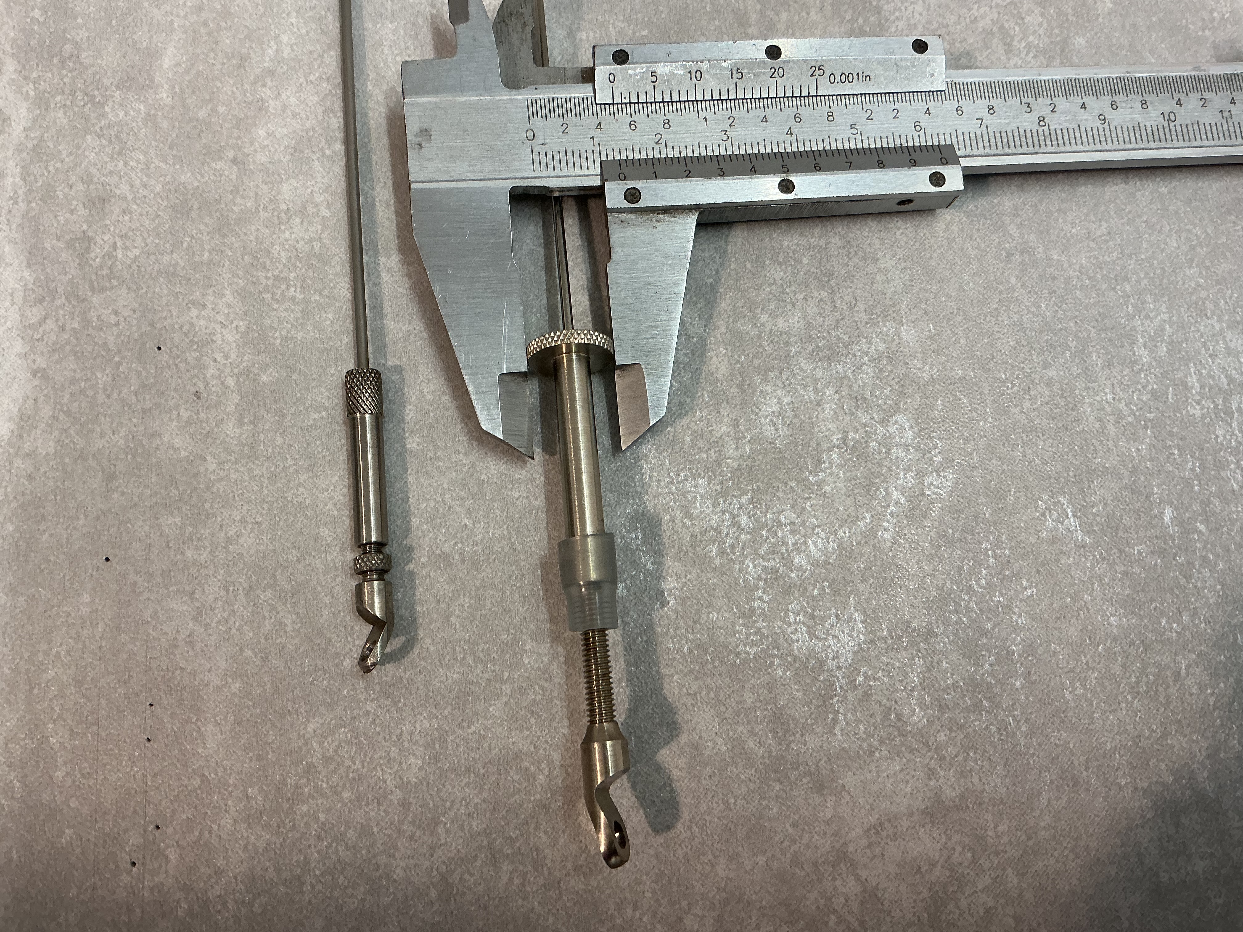

2. Attempt a rule change via the AGM. For example:
a. A quantitative rule amendment – for example, the vang must pass through a 20mm ring gauge, or boom vang fitting must be no more than 100mm from the rear of the mast, or surface area must be less than 2000 sq mm.
b. A qualitative rule amendment in the form of the Marblehead or 10 Rater rules – for example “fittings must be no larger than is reasonably required for their purpose”
In supporting the above, I would suggest minor changes for following reasons
Part a.
A reduction in ring gauge size to 15mm.
It has been argued that fittings of such size are not trying to work around rules as they are set on round booms well under the 20mm maximum height. I do not believe such a fitting requires that level of height sizing for required strength to perform its role and should be reduced more in line with the boom it controls. I believe 15mm sits closer to a fair compromise between the largest sections allowed and round booms more widely used. Ideally I believe 11mm to be the optimum that should be allowed, but concede a balanced height of 15mm would allow any current units being used to be easily modified without requiring replacement or compromising strength/structure.
Length Restriction
No larger than 125mm aft of the mast
In keeping consistent with previous interpretations within the kicker body, Kicker/Vang region, I agree that the maximum length should be no greater than 100mm. The change I would add is that a kicker/vang is commonly set aft of and a with connection to a gooseneck body. Maximum permitted for this fitting is 20mm aft of the mast. There may be overlap within connection. So my suggested change allows a tollerance to be set no more than 125mm from the aft face of the mast.
It is imperitive that any rule voted on has a length restriction matched with a ring gauge limit.

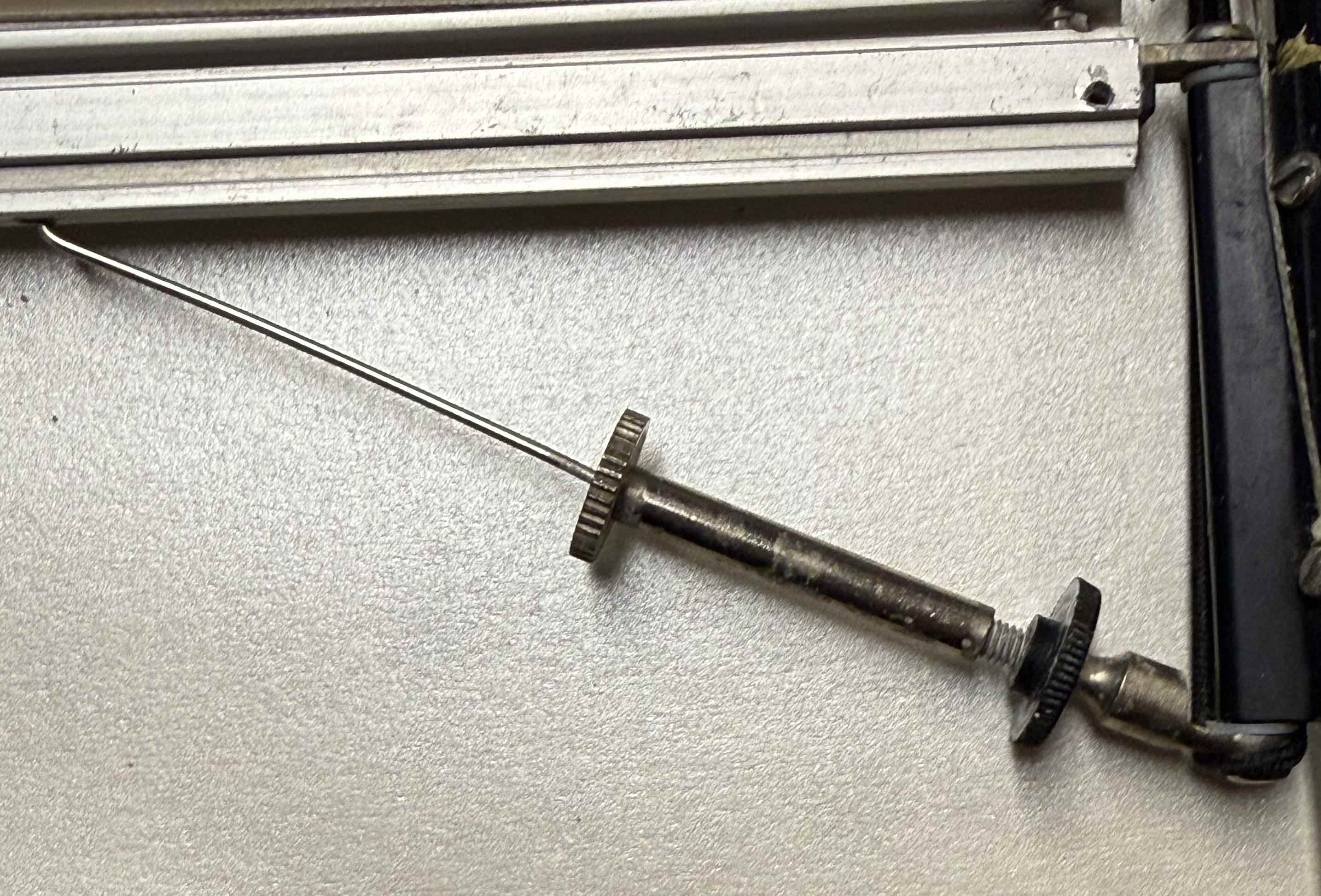

Above mentioned proposed dimensions will put out of the class vangs which many of us are using for years, if not for decades. Maybe I was not precise with measuring the diameter of the fitting sold by one reputable supplier for years but it is close or even slightly bigger than 15 mm. Recommendation of the same supplier is to have hole on the main boom for kicking strap 130mm from the fore end of the boom, which is obviously more than 125 mm from the aft of the mast (as proposed above). I am quite sure that I am not the only one using such type of vang with this dimensions.
Do we really want to put to prohibit this type of vangs?
Robert Grubiša
CRO 68
Hi Robert,
As I have not used a kicker/vang from said providor for 20+ years, I am unaware that they were actually that large!
The only large oversized wheel example from another reputable supplier here measures 12.5mm at max wheel diameter as pictured. For reference I include a fitting used since 2007 on both my Widget and subsequent designs more suited to rigs being low in the boat without unnecessary weight.
From here my 15mm ring gauge offered would seem generous without removing anyone with existing fittings designed for their purpose and nothing more.
As to allowable positioning on the boom, like above I trust a sensible figure will be discussed and reached that better defines all limitations in staying true to a closed rule set.
Brad Gibson
GBR 42

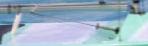

Just for info, this is from Worlds 2009Zvonko's suggestion of a 20mm x 200mm vang (ring gauge size and total length) would certainly be easy to understand and stop surface area growth. I would suggest that a 200mm length is around 50mm too much - but negotiation on size can come after agreement on the principle.
With the mainsheet post positioned at 195 mm from the mast on the Pikanto, the vang attachment point ends up roughly 180 mm from the mast. Consequently, the overall Vang length becomes even longer.
https://www.yachtsandyachting.com/news/ ... n-Barbados

For many years the kicking strap has been a simple SS wire hooked into a hole in the underside of the boom with a threaded adjuster.Andrew Crocker wrote: 21 Jan 2026, 22:31 ....snip....
For all that, there does appear some coalescing around the notion of a "two dimension" rule for the size of a vang - ring gauge + length in some way. However, as Robert and Zvonko have noted, those two dimensions could be problematic for a range of existing vangs that would, in the normal course of events, raise no eyebrows at all. In reality, what we are trying to control is surface area - so a surface area restriction makes more sense and would not cause as many problems (if any) for the examples that Robert and Zvonko cite. However, finding a calculation for surface area that is easy to implement for measurers may be very difficult indeed. So we are between a rock and hard place - more thought indeed.
Thanks again for the interesting contributions.
For some reason builders and designers felt the need to use a CF plate instead.
If the claim is the CF plate is not intended to enhance sail area, then why use it?
There must be some benefit to the CF plate vang that makes the wire vang obsolete now.
Also, as per the class rules, the vang can only work in tension and not compression.
Does this mean that if the sail is detached from the boom at the clew the boom should fall to the deck?
If not, then is the CF vang supporting the boom using compression?
How is this restriction determined when a boat and rig are being measured for a certificate?

Hi Art,
The question of a vang being in compression did arise at the 2024 Worlds. During pre-event measurement, the vang was checked to ensure that there was "play" in the adjuster such that the boom could move in the downward direction indicating no compression. It was the adjustment mechanism that determined this and not the overall design of the vang - C/F plate or otherwise.
As I speculated elsewhere in this thread, the large C/F vang shaped like an ice-hockey stick could be a response to the need to clear cockpits in narrow hulls. The alternative is an attachment point for the vang that is very close to the mast which, presumably, has an impact on the force that the vang is able to exert under load.
Regarding production, in my case, it is easier to manufacture a VISS vang than a standard wire with a threaded adjuster.
For the VISS vang, you need 2D laser cutting ( or it all can even be cut by hand ), plus a small amount of epoxy and carbon fiber.
For the wire-and-threaded-adjuster solution, you need 3D machining, which, for example, I do not have good local access to.
The real challenge is how such a limit can be measured, especially as future designs enabled by new technologies are unlikely to become simpler in shape.
In my opinion, the class should leave room for, and actively encourage, innovation and progress, rather than criticize or restrict solutions simply because they are slightly different. In my own experience, molded sails have made access to sails easier and significantly reduced waiting times, while the vang addresses the practical issue of very small vangs that are difficult to use, particularly for sailors with larger fingers and hands.
Honestly, I do not see why this topic has generated so much debate. If someone likes the concept, they are free to adopt a similar solution; if not, they can continue with their preferred setup. None of these developments has made older boats non-competitive, unlike changes such as cockpit design when they were first introduced.
Maybe we could define a surface area limit of 4,000 sq mm, which is why I suggested a 20 mm ring gauge with a maximum length of 200 mm.For all that, there does appear some coalescing around the notion of a "two dimension" rule for the size of a vang - ring gauge + length in some way. However, as Robert and Zvonko have noted, those two dimensions could be problematic for a range of existing vangs that would, in the normal course of events, raise no eyebrows at all. In reality, what we are trying to control is surface area - so a surface area restriction makes more sense and would not cause as many problems (if any) for the examples that Robert and Zvonko cite. However, finding a calculation for surface area that is easy to implement for measurers may be very difficult indeed. So we are between a rock and hard place - more thought indeed.

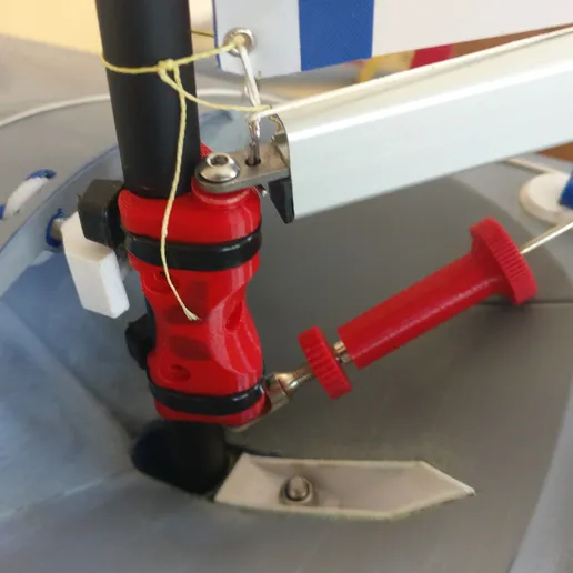

I honestly find the 20mm dimensions very limiting regarding the fitting that attaches to the mast. I developed my own designs for 3D printing; I'm not looking to increase the surface area of this part, which is largely enclosed within the cockpit and provides absolutely no extra propulsion, either downwind or upwind.
And now I realize that perhaps I misinterpreted the 20mm rule for the fitting attached to the mast (I understood that the rotating parts shouldn't exceed 20mm from the center of rotation).
The fact that I made a piece that wraps around the mast to give the 3D-printed part more strength, and combined it with the mast foot and a ring where the mainsail's Cunningham passes through might mean that this piece doesn't comply with the 20mm rule.
I'm referring to the fitting that attaches to the mast, not to the rotating parts. I'm having trouble interpreting this part of the rules, but if the part of the vang that's fixed to the mast isn't exposed and doesn't rotate, then could it exceed 20mm? It's all very confusing for me with the translator.
In any case, that 20mm limitation is problematic for making strong 3D printed parts that are accessible to a wider audience. But I'll adapt if necessary!
I never designed my vang system intending to break the rules, but now I have doubts...
When designing the parts in 3D, I mainly focus on their strength and the surface area I might gain or lose I think it's really ridiculous... as you rightly say, the differences in sail manufacturing between the maximum and minimum dimensions are much more important and are found in an area where they are actually useful.
I still think the vang's surface area limitations, given its location on the boat, are irrelevant in both modern and older boats. Even with a "VISS"-type kicking strap, most of its surface area would be inside the cockpit, contributing very little to no "propulsive surface."
As a designer, if I wanted to gain extra propulsive surface area at the stern, I might consider a higher deck to project more surface area into the wind. We could gain significantly more surface area than with a simple vang fitting, but even then, I still don't think that's the right approach.
In short, as you may have guessed, I believe the vang's surface area and the system used to regulate its tension shouldn't be restricted. This would allow for the easy creation of functional and robust 3D-printed parts, making the class more accessible to a wider audience.
If I had to vote, I would vote for this:
b.A qualitative rule amendment in the form of the Marblehead or 10 Rater rules – for example, “fittings must be no larger than is reasonably required for their purpose.”
Thank you all for reading, and I hope you understand my point of view.

Mainsail Boom Vang Fitting (attachment to boom)
- Similarly to the above, the Viss style has a plastic fitting that slides over the boom to which the Vang is attached/adjusted. To clarify, would the full side plan view of this or other fittings of such type be added to the total area measurement allowed or the total area, less the size of any boom section passing through it?
My view is that not reducing the boom element covered within the fitting would be unfairly reducing allowed area.

Dear All
Projected Area – Clarification Question
I have the same as Brad clarification question regarding projected surface area.
When the Mainsail Boom Vang fitting (F.4.3(a)(3)) overlaps with the boom—as shown in the attached picture—should that overlapping area also be included in the projected surface area calculation?
In my case, that overlapping portion is approximately 200 sq mm.
From a functional standpoint, this overlapping area does not contribute to an increased effective surface, so it is unclear whether it should be considered relevant when assessing excessive size.
Just to clarify, as far as I can see, the gooseneck that is fixed to the mast is not included in the list, and therefore is not counted in the projected surface area calculation.
VISS Vang Area Calculation
The total projected area of the Mainsail Boom Vang fitting itself is 375 sq mm, plus additional stainless steel parts that were not included in the original VISS vang calculation (as shown in the link www.iomclass.org/phpBB3/viewtopic.php?f=7&t=2111 ).
When all of these elements are added together, the VISS vang would end up over the proposed 2,000 sq mm limit.
Conclusion and Position
I have no fundamental issue with the wording or the logic of the proposed rule. However, I would strongly prefer that the allowable surface area be increased, ideally to 4,000 sq mm or at least 3,000 sq mm.
The primary reason is to leave room for future ideas and innovation, especially considering the growing use of 3D printing, which naturally enables different bigger geometries and solutions.
To reassure others:
I have no intention in the coming years to develop a larger vang or associated fittings. The molds are already made, and I am satisfied with the current design.
To reassure others:

Hi Brad, Alberto, and Zvonko, thanks all for your feedback. It is very much appreciated.
It would seem that I will need to improve the drafting of the new F.2.4(d) so that its meaning is clearer. I also take on board both Zvonko and Brad’s observation that the area of the boom vang fitting that covers the boom should be excluded from the 2000 sq mm. More drafting to be done
I will wait and see what further comments are received before I attempt that wording – but I will certainly redraft in the next few days and resubmit for your comments.
Zvonko is correct that the central element of the rule, so far as it concerns the gooseneck and mast vang fitting, is that they must rotate (i.e. when the boom/sail swings, they swing) for their area to be counted in the 2000 sq mm. That part of the gooseneck and mast vang fitting that does not rotate is not included in the 2000 sq mm limit.
I have attached an image of a randomly selected (via Google images) 3D printed gooseneck (by historical3dmodels). As Brad notes, its size is larger than a metal/CF equivalent, but it is also clearly “… no larger than is reasonably required”. As it does not rotate (it is permanently attached to the mast), its area is not relevant to the 2000 sq mm limit. The 3D printed vang component, however, does rotate with the boom/sail and so a measurer should satisfy themselves that its surface area is less than 2000 sq mm (which it clearly is). To slightly complicate matters, some feedback from Olivier Cohen has made me realize that I need to change the words “… sum of the projected surface areas …” to be “…sum of the surface areas of the projected perimeters …”. By this I mean that any interior features (such as holes in particular) should be ignored for the purposes of the surface area calculation.
Given that, what my “… projection of surface areas shall be to the centre plan of hull with the mainsail boom centred …” is meant to mean is this: if you remove the rig (mast, sails, etc) intact from the boat, lay it on a flat surface, and then trace around the boom vang fitting, vang, and any rotating parts of the gooseneck and mast vang fitting with a pencil, the resultant shapes are the ones that have their area measured.
Importantly, I would note that there should be no requirement for a measurer to record the areas calculated using the above method. The measurer should be required only to satisfy themselves that the sum of the surface areas is less than 2000 sq mm. Given that the sum of the areas of the “old faithful” vang/gooseneck/boom fittings shown in my last post are so far under 2000 sq mm (indeed, one could be 200% out in calculation and it would still be compliant), a quick glance at such a fitting by a measurer should be enough for that purpose. When designers currently seek clarification on the compliance of new rotating gooseneck fittings, there are asked to provide drawings/pictures that allow a determination to be made as to their compliance under the current F.2.4(d) (i.e. the 20mm rules). I would expect the same for fittings that might need measurement under the 2000 sq mm rule to ensure their compliance.
Finally, to Zvonko’s suggestion that the allowed area be greater than 2000 sq mm. I would observe the following:

If I may, I would like to make a proposal that meets Darin Ballington's request and which I believe could be a acceptable basis:
- if the vang falls within the defined standard dimensions (see attachment): for example, maximum dimensions of the knurled part used for adjustment and others little parts: Ø15-16mm maximum thickness 10mm, maximum length 50-60mm with a maximum diameter of 8mm excluding the M4 threaded part, which is irrelevant, then the vang is to be considered compliant;
- in the case of vang with complex profiles, the manufacturer must produce a calculation statement based on the projected surface area as discussed above.
This would create a situation in which, with two simple measurements taken with a caliper (if there are any doubts), conformity is established; otherwise, the manufacturer will have produced a statement with an attached calculation to be presented to the judges.
I am attaching a sample sketch to highlight what I mean by a standard vang that takes into account what is produced and the requirements of 3D printing. Obviously, this can be modified.
