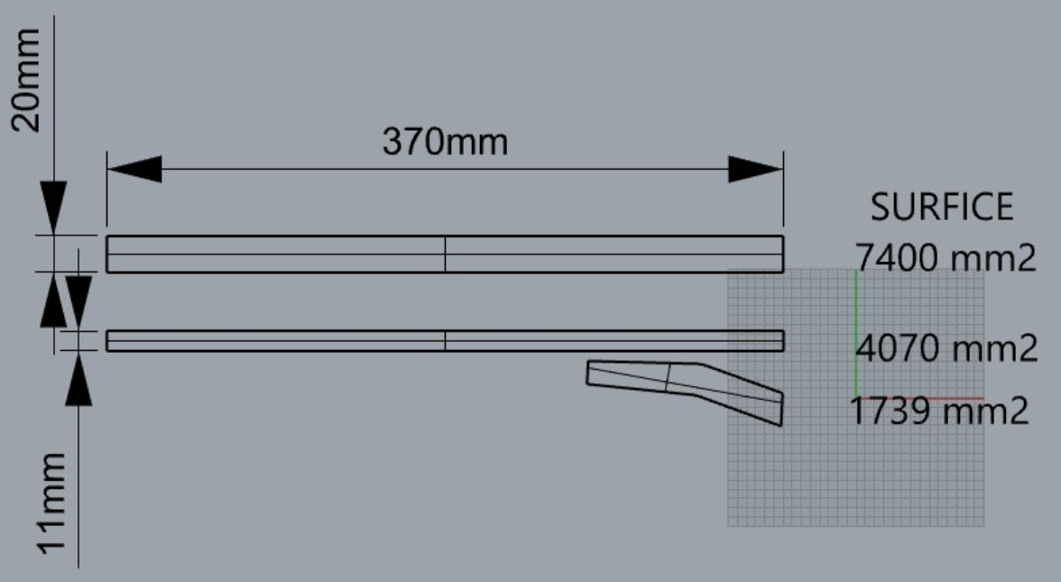

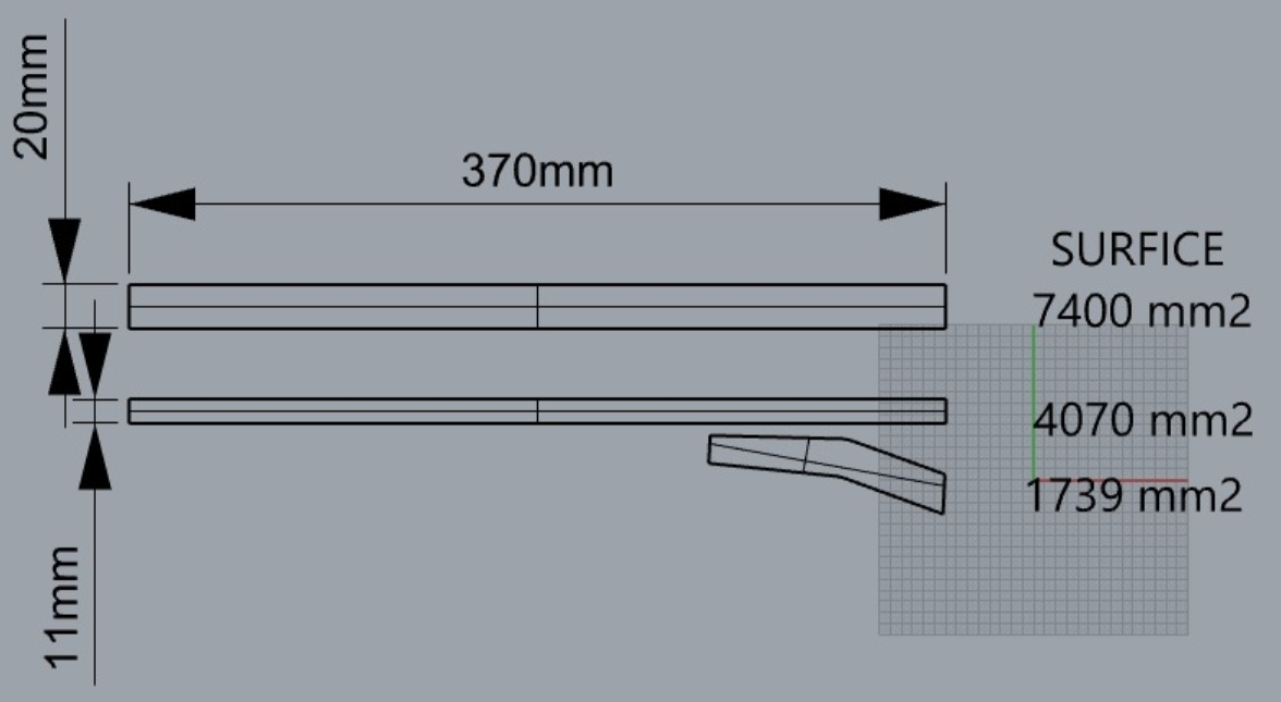

The main concern raised was the size of the kicking strap, with the suggestion that it might provide increased surface area. I would like to confirm that this is not the case, and I will provide exact measurements of my kicking strap to support this..
As illustrated, if the goal were to increase surface area, the logical solution would be to maximize the boom dimensions and use a square cross-section (as shown in the top image). In contrast, enlarging the kicking strap while using a smaller, round boom (as shown in the lower image) would not be an effective way to achieve that. This clearly shows that the design of my kicking strap was based on functional and structural considerations.
The kicking strap has a slightly curved shape, intentionally designed to better follow the contour of the boat and to allow for proper attachment to the boom at the desired length. This size was necessary to achieve the required structural stiffness while keeping the weight as low as possible, which is the configuration I currently use.
What I find unclear is why France waited so long to bring this proposal forward. Why wasn’t it raised immediately after the 2023 European Championship in Torrevieja (ESP), when there were only two prototype boats?
I believe this proposal is very dangerous — it is the first time I am aware of an NCA proposal that could effectively make certain boats illegal if it passes. In the past, I was prevented by senior IOM CRO members from proposing changes such as a carbon mast or a square-top mainsail, since those could have caused problems for some boat owners. I hope I will not be stopped in the future, especially if the FRA NCA proposal is accepted.

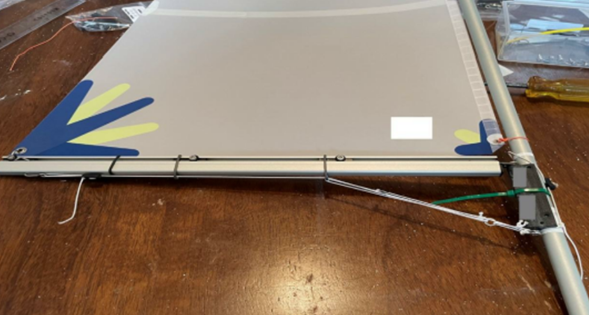

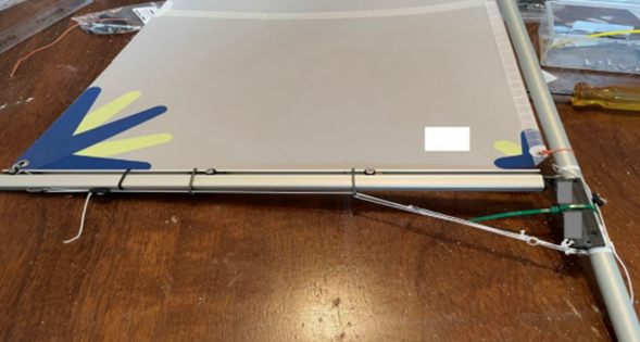

a) No problem there. This is just applying the modified ERS definition.
b) The issue is that adding more attachment points makes the kicking strap complicated.
My first (very quick) idea based on this new proposal is similar to what’s shown in the picture – a reinforced kicking strap with extra attachments. It can be easily made using deck patch material (shown in orange in the picture). Over time, this approach could even evolve into more complex shapes with multiple attachment points.
The real question is whether this is actually needed for the simple vang usage shown in the picture, since the same function can already be achieved with a slightly different (and allowed) setup. The Technical Committee can correct me if I’m wrong, but just look at the QA Is controlling of the fixed length kicking strap tension using screw in the main boom, a knurled nut and a slug that connects via a rod to the kicking strap strop that attaches to both sides of the boom permitted?
In short: To make the kicking strap (vang) arrangement shown in the USA proposal allowed under the current rules 2022, you need a stainless steel ring that slides along the boom as the kicking strap (vang) attachment point.
The rope with a bowsie should be tied to the stainless steel ring only. This setup should then be considered an adjustable kicking strap (vang) fitting, since its sole purpose is to adjust the position of the stainless steel ring. So this way there is no need for any rule change nor more complications as it smoothly resolves this issue.

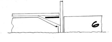

So just to clarify — you’re okay with this (see picture):
where the well is partially closed off by a plate (shown as solid) attached to and flush with the surrounding deck.
This is from: https://www.iomclass.org/iom-questions-and-answers/
I’m wondering, what’s the purpose of that, and where is it expressly permitted to have a double deck according to the closed nature of the IOM class rules?
And we’ve had double decks for at least the last 20 years.
