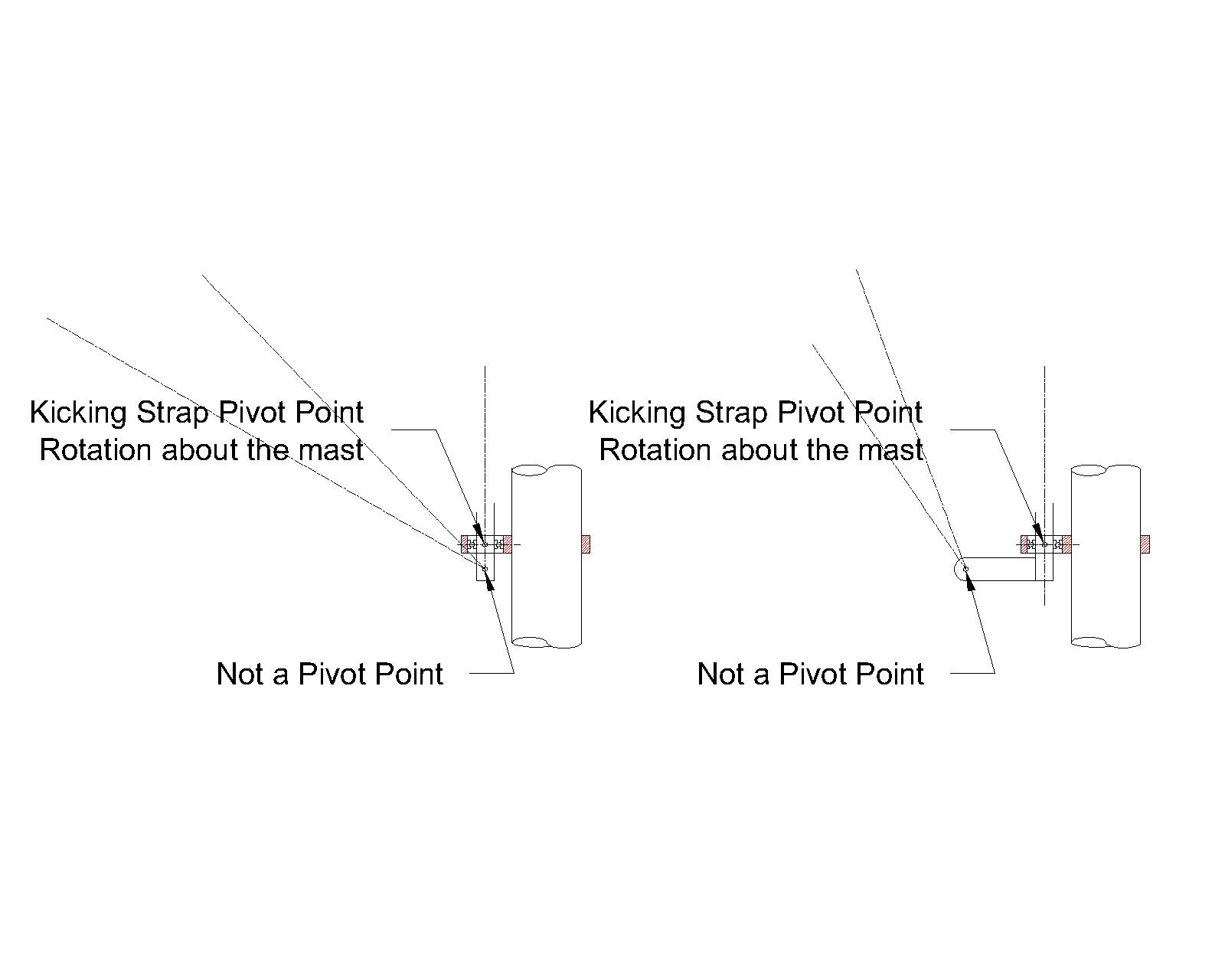

now that this rule change has been voted in, we need to clarify it:
1) all gooseneck fittings obviously rotate about a plane parallel to the mast, but some also have rotational adjustment perpendicular to the plane of the mast to allow variable vang tension between close hauled & downwind boom positions - to be strictly correct, we need to specify which axis of rotation is in question.
2) assuming we are only concerned with the obvious axis of rotation, where do we measure it?
It could be the exact center of the axle that goes through the ball bearings - this might be hard to measure accurately and consistently while on the rig.
It also could be the outer edge of the bearing housing (the cylindrical part that holds the bearings) - this is not strictly the "axis of rotation" but is easy to measure while rigged.
I imagine this was the dimension the rule writers had in mind so as to limit the size of the flat plate portion of the vang fitting, but opens the door for all sorts of ways to mould funny rule beating bumps in the fitting.
Perhaps rather than use verbiage to describe our goal of preventing vang fittings from getting too large, a simple right triangular template with one side on the mast and one side on the boom thus using the hypotenuse to define the maximum size of the fitting might be more useful.

After some introspection:
One might assume that since the rule specifies that "where the mast kicking strap fitting and/or gooseneck: ...are not of circular cross section...." that the 20 mm dimension begins where the fitting is no longer of circular cross section eg. the flat plate portion of the fitting.
The verbiage about the axis of rotation does not relate to the actual measurement of the non circular dimension thus eliminating the need to define it.
IMHO, the rule suggests that the flat plat portion of the vang is measured from the aftermost edge of the cylindrical moulding that holds the bearings
I have seen several drawings from various sources which define the point from which the 20 mm dimension is measured: all are different from one another.
Rather than have the measurers from each NCA come up with their own interpretation it might be nice to have VC Tech post the official IOMICA definition of the point from which the 20 mm limiting dimension is measured. An illustration would be nice.
Alternatively, an NCA could force the issue and ask for an official interpretation.
Even nicer would to have this discussion open to the general membership from the beginning.

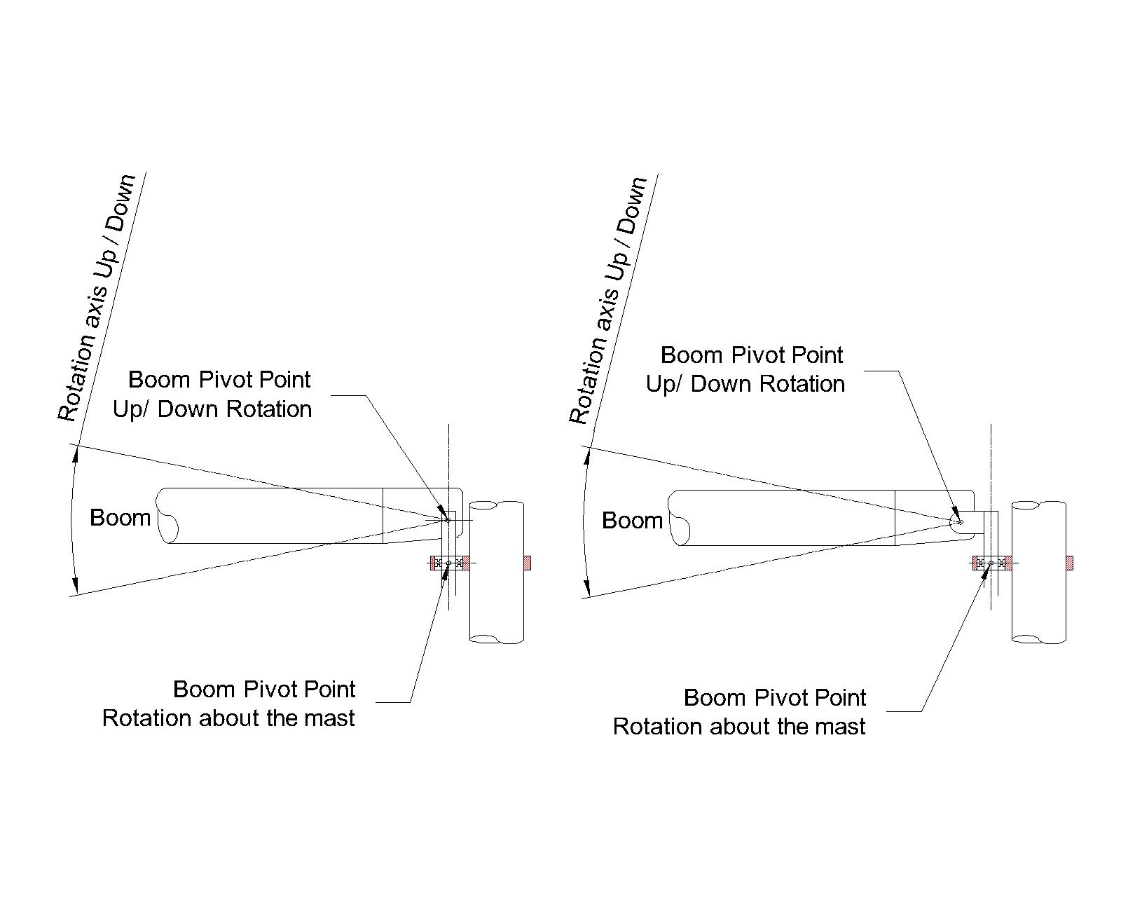

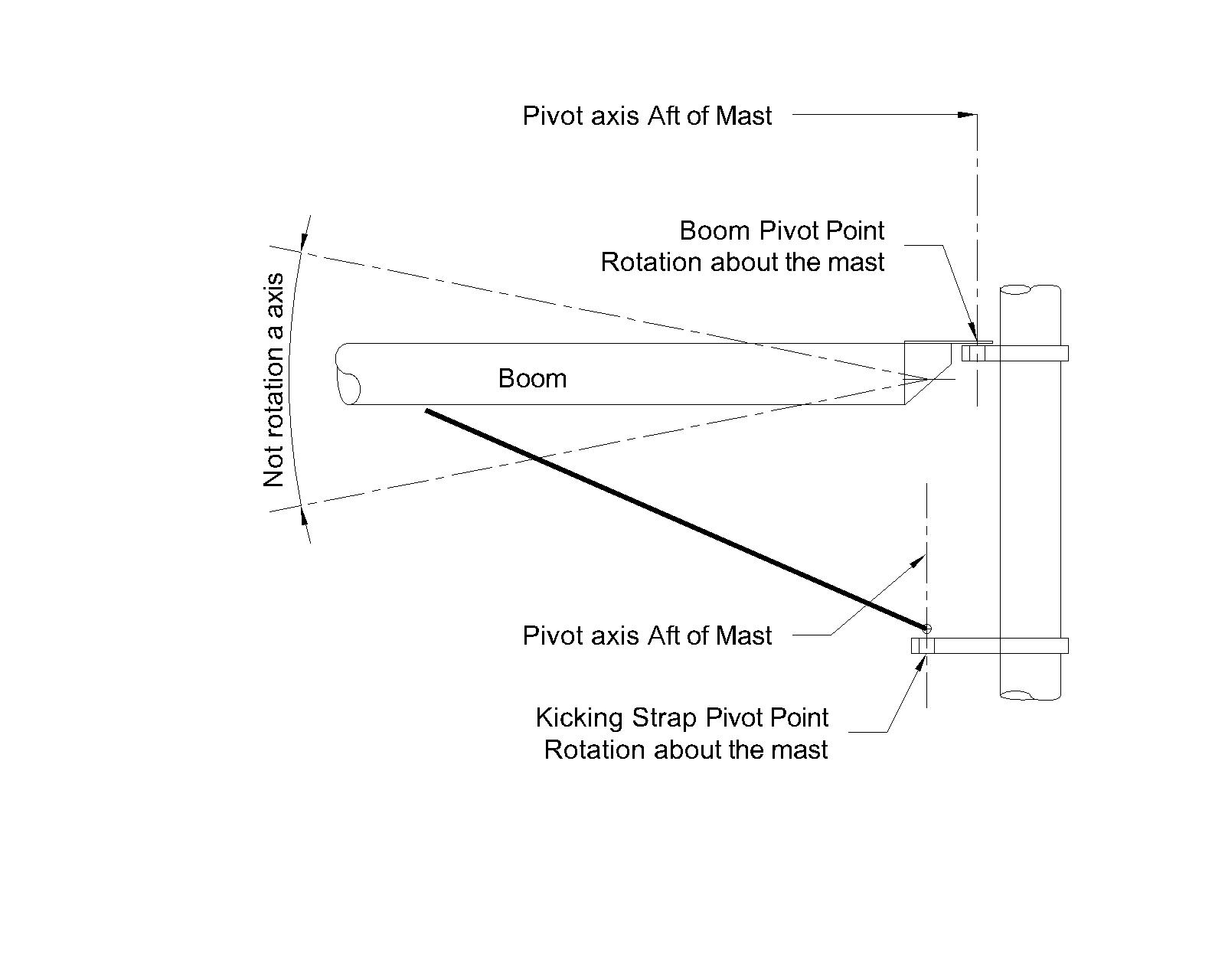

Even though my little sidebar identification probably says I am Secretary, I am not.
But, I believe that very shortly there will a diagrammatic representation of what will be considered the correct way to measure this fitting. If anyone thinks that there is another way then the real option is to lodge a Request For Interpretation. I think the diagram will make it clear what the correct way will be.
THe draft is floating around so it should be posted very soon.

thanks Barry - saw the drawing - clearly defines what IOMICA thinks the rule actually says - should have been part of the rule all along IMHO

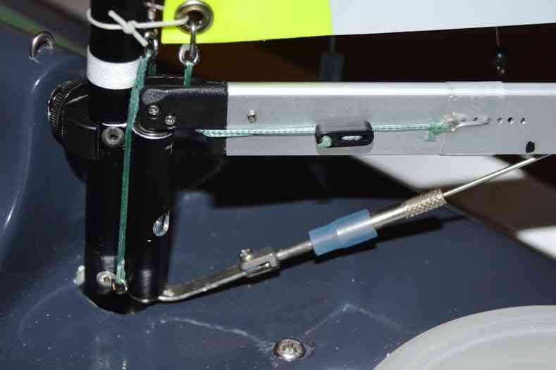

This picture was posted on another forum with the question "Is this compliant under this new rule"?
The plate connects the vang to the pivot screw - but it is exposed, it rotates, and it is longer than 20mm.
Or is the plate part of the vang? Contrast with second picture where the lower vang screw section attaches directly to the pivot screw.
John
John

One thing the plate GN does is take the attachment point of the mandatory kicking strap fitting F.3.3(a)(4), and the optional mainsail GN fitting F.4.3(b)(2) and move them aft of the GN vertical axis of rotation. This is not specifically permitted by the CR. Normally, until the plate GN came out, the main boom fitting and kicking strap fitting were attached to the GN body at the GN axis of rotation, as in John Ball's picture of a standard Bantock GN a few posts up. So an argument could also be made that the plate GN does not comply with CR F.2.3 Limitations.
The IRSA gives some background in their ruling on the 2015-IOM-1 Interpretation.
Here's a link to the IRSA document:
http://www.radiosailing.org/documents/c ... 15-t-iom-1
Seems " the plate is not a permitted fitting or termination in its own right."

In an attempt to address this statement, "So perhaps someone could explain how, even within a closed rule, could this small band of experts might have concluded that this particular type of gooseneck fitting is non-compliant with any part of the relevant Class Rules. And that there was any necessity to introduce a new rule , emergency or otherwise.", I pointed out what I see as one fundamental difference between the plate GN and the standard and ball raced GN's widely used before the plate GN came out. That is, the plate GN moves the attachment points of the mainsail boom or optional main boom to GN fitting, and kicking strap fitting aft of the GN axis of rotation. Does this extend the function of the GN beyond what is permitted ? Maybe so... maybe not. I don't believe the CR clearly address where these attachment points are to be.
CR F.3.3(c)(2) comes close to addressing where these attachment points should be, but seems to get pretty vague at the end.
It says : " The mainsail boom spar and the kicking strap pivot points shall be aft of the
mast spar in the regions adjacent to these points."
Too bad it doesn't end with " the region adjacent to the mast spar" or "at the GN axis of rotation." Then we might not be in this situation. To be honest, I'm not sure what CR F.3.3(c)(2) means. I would like to see this rule clarified.
The point is, there are grey areas in the rules. Some rules are very clear, some not so much.
One thing I'm pretty sure of, the Class Rules don't specifically permit something they don't even address.
So along comes a plate GN where the whole vertical body rotates on ball bearings and the main boom and kicking strap attachment points are moved off-axis. This difference is not addressed by the CR. This reasoning is not in the interpretation that made plate GN's illegal. Just my opinion about one possible justification for the ruling.
As a class measurer here in the US, I should of said something. So in a way, we measurers bear some responsibility for this SNAFU. Unfortunately the plate GN went un-scrutinized for far too long.
When the plate got taken to the extreme, Interpretation 2015-IOM-1 addressed the issue. Plate GN's were ruled non compliant, and a rule change became a necessity or they would still be illegal. Basically a judgement call was made.

David, could you clarify these statements please.
" F.3.3(c) (2) The mainsail boom spar and the kicking strap pivot points shall be aft of the mast spar in the regions adjacent to these points.
Examine F.3.3(c) (2) In particular the passage ‘in the regions adjacent to these points.’
This does not refer to the strap attachment but to the a boom articulation point Up / Down and Left Right
The word adjacent is perhaps a little loose but the actual issue is the other end of the fitting."
Perhaps I'm reading the rule wrong, but as this rule is in section F.3 Mast, I take the "pivot points" to mean the attachment points of the main sail boom spar and the kicking strap fitting [F.3.3(a)(4)] to the gooseneck.
Are you saying "The mainsail boom spar and the kicking strap pivot points...." refers to points where the boom and kicking strap pivot up and down ?
What does the second use of the word "points" refer to?
Are you saying this rule allows the up & down pivot points and the in & out pivot points to be separate ?
Your statement : This does not refer to the strap attachment but to the a boom articulation point Up / Down and Left Right "
The rule is in section F.3 Mast and refers specifically to "mainsail boom spar and the kicking strap pivot points"...
If this rule were addressing a main boom (up & down) pivot point, separate from the in-out pivot point,
shouldn't it be in section F.4 Booms ?
"This does not refer to the strap attachment" ... Which "strap attachment". Do you mean the mandatory mast fitting that attaches the kicking strap to the gooseneck F.3.3(a)(4) ? I'm lead to believe it does refer to this fitting as it's in section F.3 Mast.
When you say, "The word adjacent is perhaps a little loose but the actual issue is the other end of the fitting."
The other end of which fitting?
To me the word "adjacent" is one of the clearest things about this rule. I take it to mean right next to, adjoining, very close, less than 20mm
etc.

The fundamental of any Rule, Law or Contract is what it states:-
CR F.3.3(c)(2) The mainsail boom spar and the kicking strap pivot points shall be aft of the mast spar in the regions adjacent to these points.
Take the first part and forgive me if my approach is too simple.
The Boom Spar pivot point and Kicking Strap pivot point are two totally different points and lay one above the other.
Similarly the rotational pivot point and the up and down pivot points are not necessarily the same point.
These two or possibly 4 independent points having been collected in the sentence and hence become plural i.e. Points . This does not in any way imply them to be the same point or indeed that they are axial.
The term pivot does not restrict or imply any particular rotational axis, however since there is no other rotational axis other than roughly about the mast axis it is not required.
In real term there is no UP and DOWN rotation , Up rotation is prevented by the Kicking Strap and down rotation prevented by the sail.
However being puritanical about it there is UP and Down Rotation which may only take place at a Pivot point or a location ADJACENT to it.
In other words the up and down articulation axis need not be coincidental to the rotation axis but must be adjacent, adjoining, neighbouring - refer Oxford Dictionary
So all this states is that these point SHALL be aft of the MAST and Adjacent
It has nothing to do with the sail.
Ok so far...
Ok so far...
- GooseNeck 2015 B.jpg (93 KiB) Viewed 72094 times

Re: 2015 AGM - Topic: Ratify Emergency Class Rule
First focussing upon the Boom Pivot Point
When these two points have become separated as they do in a fitting equipped with a ball bearing the two points are still required to be ADJACENT as they are. Adjacent does not however refer to a plane and in the sketch the two point are vertically adjacent but just a validly could be horizontally adjacent.
You will note that the pivot point of the bearing is the centre of the bearing.
A point is a point in XYZ - is not a vector and
Whilst an Axis is the line described between two points.
- GooseNeck 2015 C.jpg (107.78 KiB) Viewed 72093 times
David L Alston
- Posts: 72
- Joined: 24 Jul 2012, 17:38
- Sail number: 3011
- Club: Leicestershire RYC UK
- Design: Fatboy
On to the Kicking Strap End of the fitting
There is only one rotation axis, it is about the Mast. There is NO up and down rotation. This is because it is eliminated by the strap itself.
The rule relate to the fitting not to the components comprising the fitting. This is an important point since what we refer to as the Kickstrap is the wire bit and the adjuster is but a component part of this fitting. There is no qualification as to the number of the component parts or their dimension only their function.
John Ball posted a picture earlier of a common simple kick strap with a plate jointing the ADJUSTER to the PIVOT POINT. This plate is a Component part of the Adjuster, there is no articulation at the joint between the plate and the adjuster. It could have been made in one piece could it not or the bolt joining then could be tightened such that it formed a rigid assembly.
I believe that I have shown that NO Relevant / Applicable Class rule has been contravened would you not.
There is no vagueness in the Class Rules it is only a few that will insist upon trying to find alleged non-conformance.
- GooseNeck 2015 D.jpg (84.32 KiB) Viewed 72090 times
Dick Carver
- Posts: 55
- Joined: 23 Nov 2003, 22:06
- Location: USA 22
David
Thanks for the drawings. They're very helpful. I have a much better understanding of CR F.3.3(c)(2)
Would you agree that separating pivot and attachment points for boom, and pivot & attachment points for
kicking strap, by several millimeters of carbon plate makes these points no longer adjacent.
In March of 2015, Interpretation 2015-IOM-1 came out. At that point, plate GN's became illegal.
However, the 2015 Foster City Worlds were rapidly approaching. I believe they were scheduled to begin on May 9th.
Much discussion took place between event organizers and IOMICA officials regarding how to give WC participants some
relief from having to swap out their goosenecks only weeks before the Worlds.
IOM Class Rule A.9.2 in conjunction with RRS 87 CHANGES TO CLASS RULES was used to allow existing plate GN's to
be used at the 2015 Worlds.
However, A.9.2 says the rule change is only valid for the event. So when the Worlds concluded, Int. 2015-IOM-1 came back into effect and plate GN's reverted to being illegal.
This necessitated an Emergency Class Rule change to allow existing plate GN's to be used (with some modification), until a regular Class Rule change could be voted on by class members at the next AGM.
I have to disagree with your characterization of IOMICA and IRSA officials. I'll admit that I don't always agree with all of their decisions, but I'm willing to go along with them. We have mechanisms by which we can change our class rules if we so choose. But while competing, RRS 3 ACCEPTANCE OF THE RULES governs us.
I do know this : leading up to the 2015 Worlds, the work load on the Technical and Events Subcommittees was huge.
MANY people put in countless hours on a voluntary basis to make the IOM class work.
That's probably why we don't see a lot of people stepping up to take these jobs.
They aren't "bureaucrats" or "wannabe administrators".
They are dedicated volunteers who put in a ton of effort to keep this class going.
Like I said, while I don't always agree with, I'm glad we have them.
