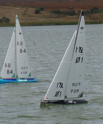

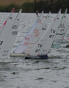

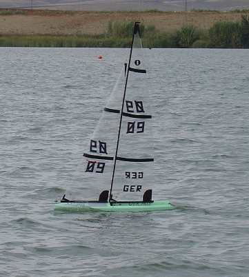

In Arcos 2004, the umpires had problems with sail numbers in the range 00 to 09 and they fixed this way
John Ball
Posts: 295
Joined: 06 Jan 2006, 00:47
Sail number: CAN 307
Club: West Coast Radio Sailing
Design: V8
Location: CAN
Canada
Re: The new ISAF RRS 2013-2016 are out
Post by John Ball » 16 Jan 2013, 18:37
I love it! Simple, cheap and elegant!

Problems may occur when in a race one of these numbers is repeated and should put a prefix. I think it would be better if everyone put a stripe just under the last digit of the sail number in all sails.
Lester
Posts: 628
Joined: 14 Oct 2004, 22:29
Location: GBR 105
Post by Lester » 18 Jan 2013, 10:39
Xabier wrote:I think it would be better if everyone put a stripe just under the last digit of the sail number in all sails.
Hi Xabier
I think there may be a couple of problems with that, especially at a larger event (smile)... What would I hail if I wanted to protest? And, what would the scorer enter into the results spreadsheet when recording the finishing place?
Lester Gilbert
http://www.onemetre.net/
Xabier
Posts: 24
Joined: 22 Jan 2009, 14:48
Location: Euskalherria (Basque Country)
Post by Xabier » 18 Jan 2013, 12:59
I know my bad English is a problem. My idea is to put 81, with a line, to distinguish from 18, 08 from 80, 51 from 15, 188 from 881, etc.
Lester
Posts: 628
Location: GBR 105
Post by Lester » 18 Jan 2013, 13:13
