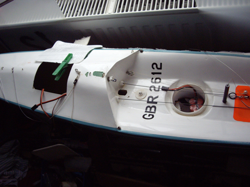

Further to the above, which I posted unfinished by mistake.
The photograph shows the situation as it currently stands and the problem I am trying to avoid. I can't attach a drawing as I do not have a scanner.
What I would like to do is:
Lash the fitting onto my new mast section using Kevlar tow and a drop of resin. This option is dependant on whether this is a permitted method of "fixing".
A harder and slower method would be:
Use an off cut of the old mast as a mould, coat with mould release agent, and lash the fitting onto the mould using Kevlar tow and a drop of resin; slide the fitting off the mould and onto the new mast section; fix in place with glue - very similar to my first option and preferable to screwing it in place, which wouldn't actually solve anything.
I hope this clarifies my questions.
I look forward to your reply.
Thanks and regards,
James
