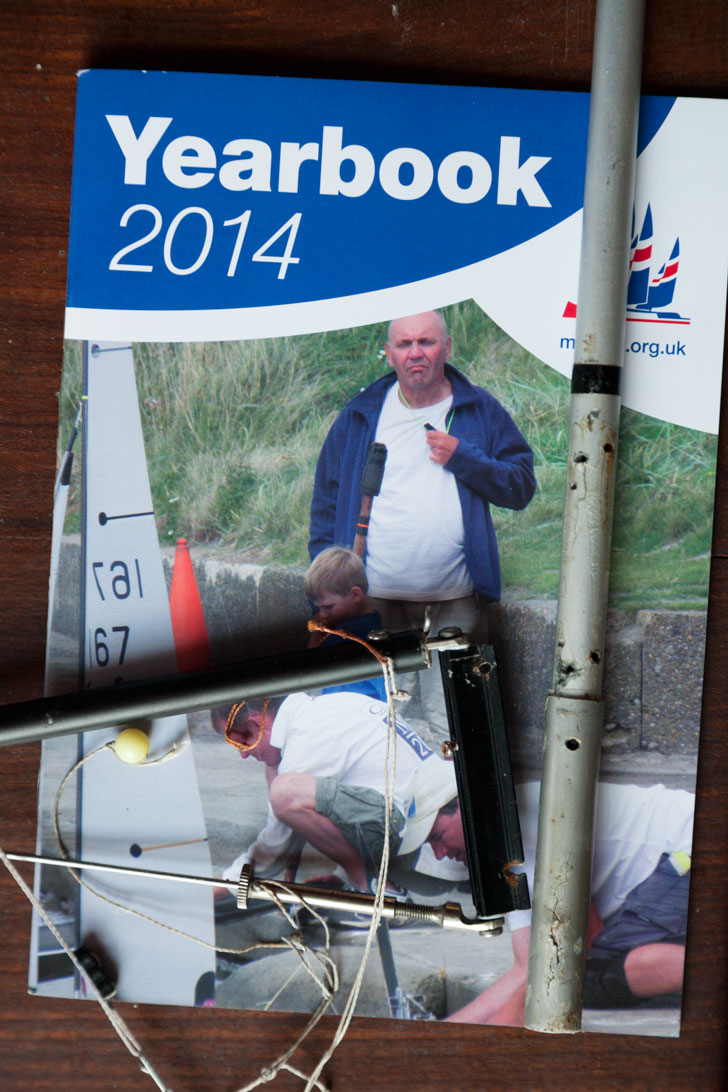

The photograph shows the situation as it currently stands and the problem I am trying to avoid. I can't attach a drawing as I do not have a scanner.
What I would like to do is:
Lash the fitting onto my new mast section using Kevlar tow and a drop of resin. This option is dependant on whether this is a permitted method of "fixing".
A harder and slower method would be:
Use an off cut of the old mast as a mould, coat with mould release agent, and lash the fitting onto the mould using Kevlar tow and a drop of resin; slide the fitting off the mould and onto the new mast section; fix in place with glue - very similar to my first option and preferable to screwing it in place, which wouldn't actually solve anything.
I hope this clarifies my questions.
I look forward to your reply.
Thanks and regards,
James
Thanks and regards,
James

I do not quite understand WHICH problem you are trying to avoid.
1/ The terribly bad workmanship clearly evident - This I am afraid is well beyond the scope of the Class Rules.
2/ The corrosion cause by Stainless Steel in contact with the Aluminium
3/ ???
There are a hundred way to recover the mast if you really want to ... but in an earlier post you said you had got a new mast.
Here are the degrees of freedom you do have.
You MAY
1/ Tie the gooseneck to the mast with whatever material you like and resin it
2/ Push piece of plastic or aluminium tube up the mast so the screws bit into the plastic
B&Q sell a section of tube that will go up a 11.2 mast with a bit of sanding or slotting
MAY almost do anything you like BELOW the BOTTOM Mast Band - 1600mm
3/ Extend the 12.5mm section up to the Bottom Mast Band
4/ Offset the bottom of the gooseneck by about 0.7mm - you may find this useful.
5/ Only fix the gooseneck with two machine screws on the centre
I hate self-tapping screws
I am not sure why you attached a Race Result !! I will confess I did not recognise a single name but was impressed by the numbers - All I asked is - where you are sailing since it seemed the club was not MYA affiliated and I had never heard of it.

1/ The "terribly bad workmanship" is down to the previous owner(s). I am not trying to recover this situation.
2/ "The corrosion cause by Stainless Steel in contact with the Aluminium." - Yes. I am trying to avoid as many potential causes for corrosion as I can.
3/ My biggest worry is based on past experience:

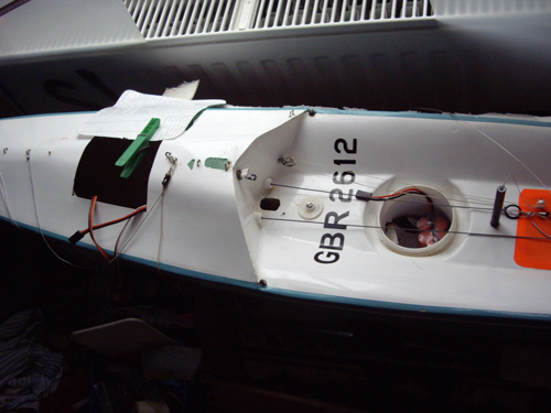

I was able to sail last week with a temporary arrangement held together with cable ties and a spot of glue, which worked fine. Unfortunately my temporary arrangement for the spreaders was a bit too temporary but the wind was relatively light so I could continue - not very pretty but...
My boat was registered to David Roberts and, I believe, built by David Creed - it has a moulded deck with the mast step 80mm below the "..deck limit mark.." so fortunately doesn't slop about. I wish you every success at the Championship - I see you are 35th after 4 races. A couple of our regulars are competing 'though not doing so well to date - Tom Lance 15, and Mike Brown 118 - and several are watching part or all of the event. I am registered through Emsworth Slipper SC. We sail from Emsworth SC's car park and pontoon every Thursday - some early arrivals can be seen warming up in this Google Maps link https://www.google.com/maps/place/52+Ba ... 853fe88c24 and from Emsworth Slipper SC's club house/pontoons on Tuesday evenings in the summer and Sunday mornings in the winter https://www.google.com/maps/place/52+Ba ... 853fe88c24
Unfortunately my health problems mean I am frequently unable to complete a whole morning's racing and almost certainly won't last a whole day so, much as I would love to compete in/visit the Nationals, it is not on. C'est la vie...
Thanks again for all your help.
