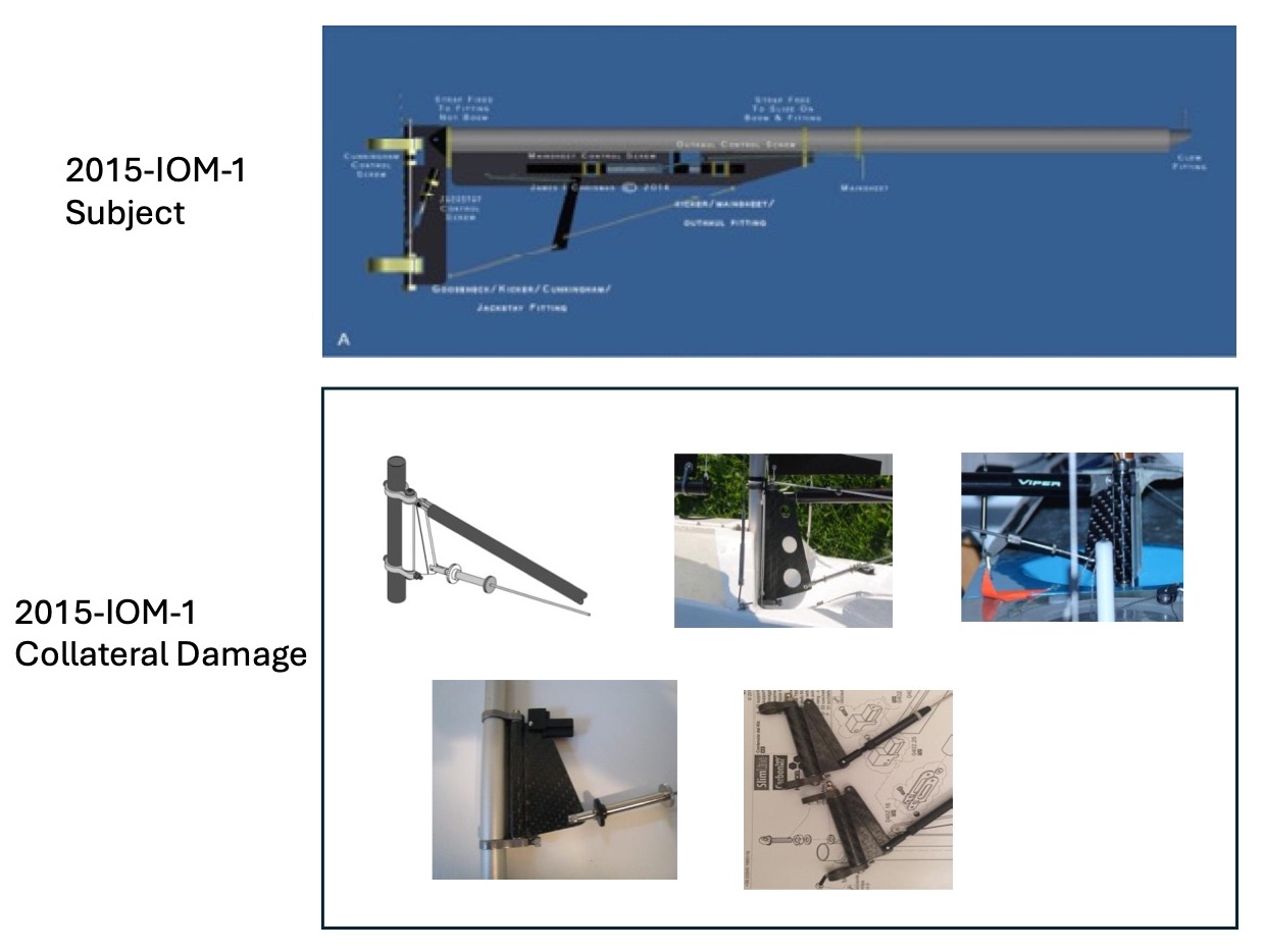

As to the past and the Potter gooseneck. I was not a part of what happened 10 years ago, and I am therefore dependent on anecdotes and contemporaneous accounts to flesh out the actual Interpretation (2015-IOM-1) and subsequent rule change (F.2.4(d)). Additionally, as Jeff has done, several people have communicated to me (both within this forum and privately) their frustration with the apparent differences in approach between then (restrictive) and now (permissive). However, the Interpretation and its aftermath are instructive in this regard.
The devices that triggered Interpretation 2015-IOM-1 are shown at the top of the attached image (2015-IOM-1 Subject). Both devices were determined to be not permitted – both because of size but, in the case of the combined gooseneck and vang fitting, because it was interpreted that the Class Rules did not allow this arrangement.
The narratives following the issuing of Interpretation 2015-IOM-1 indicate that the ruling caused a range of existing gooseneck fittings to become non-compliant - examples of which are shown at the bottom of the attached image (2015-IOM-1 Collateral Damage, taken from the IRSA proposal for Class Rule F.2.f(d)) and the Potter gooseneck was one of those impacted. The Emergency Rule change was implemented (Class Rule F.2.4(d)) that essentially negated Interpretation 2015-IOM-1 and again permitted these fittings (provided they complied with the 20mm dimension specified).
Interpretation 2015-IOM-1 and its subsequent difficulties demonstrate the need to consider the practical realities of the IOM class in finding an appropriate balance between restrictive and permissive perspectives. This continues to be the objective of the current process.
