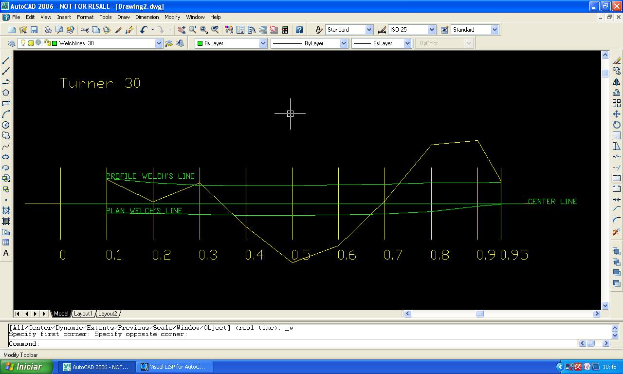

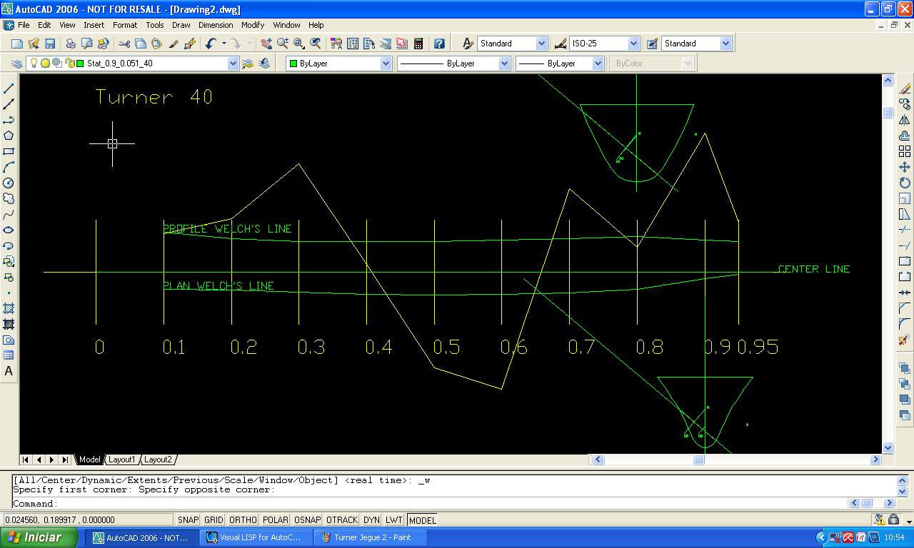

I do a Turner study for my new design but as is the first time that I do this I am a little confusing in take conclusions.
Can someone help me?
The figures annex are from an autolisp program that I do to run in Autocad. After I prove that it is running OK I will make available here.
If somebody has a table of offsets with a Turner's graphic already do and send me, I can test the program more quickly.
