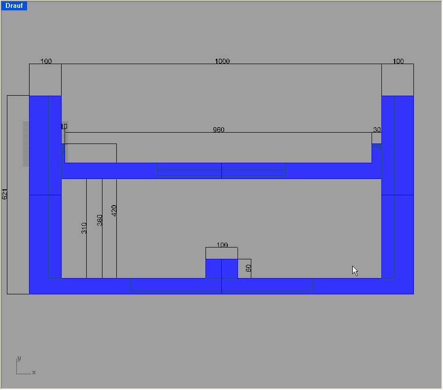

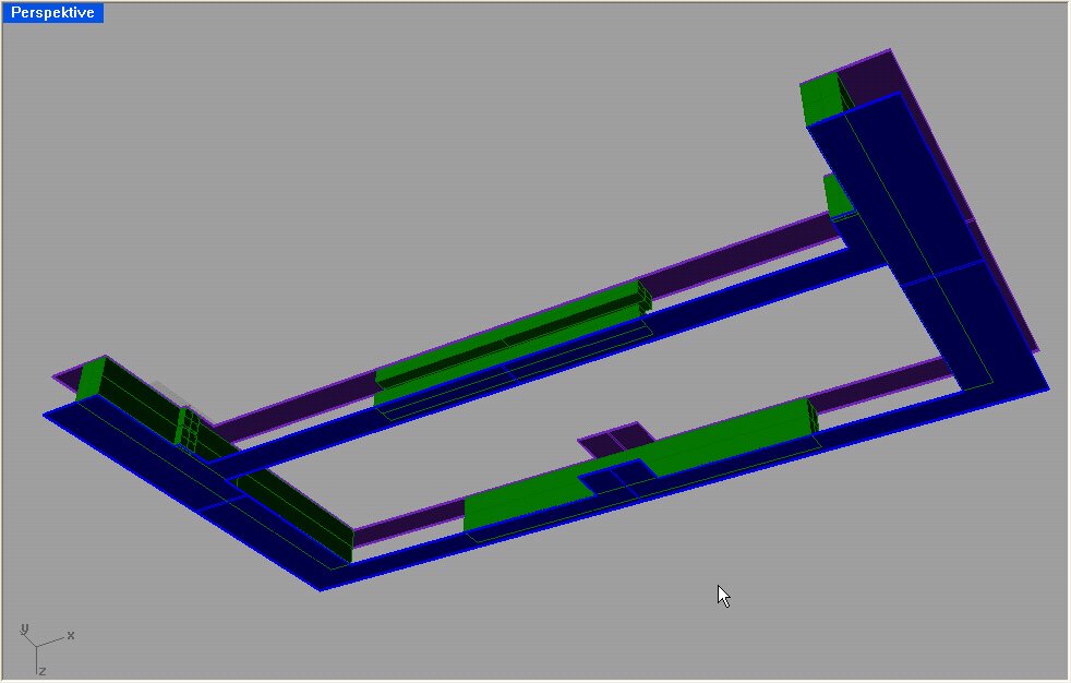

I know that my proposal is a relatively complicated an expensive looking construction and surely we won´t get it (basic material and laser cut) as a gift (Question: Who knows a good sponsor for 20..30 pieces...?). but if we want to have an real alternative to a tank we must go this way.
I tried to use the existing rules (and hope there will be no mistakes).That´s why there shouldn´t be no limitations of hull shapes (think about Michael S.´ boat
) so that such a gauge should only work in the dimensions of length and depth for measuring hull properties. Only the keel (and rudder, o.k.) has draft limitations.
If we want to have a gauge it should be ONE FOR ALL. Now, look:
General construction (all to be read with "cold be", of course):
The gauge consists of 2 (laser cutted) pieces of sheet metal (2mm steel or 3mm aluminium) and several (massive) blocks or tubes between them.
Side view:
The choosed distances are my proposals - especially the waterline length. It could also have a distance of 950mm, however, I´m relatively sure that there will
be only a few existing constructions with a shorter water line and a max hull depth (at the same time).
Left:
The vertical cut at the 10mm full metal block is for checking the rudder and helps keeping the measured boat in the middle of the gauge.
Right:
There could also be a little (2...3mm) vertical cut to fix the hull, but I didn´t drawn it.
Middle:
The 2 upper blocks are for measuring hull depth (60mm) and keel draft (20mm distance). At one end there could be a joiner to fix the distance (also not drawn).
With the "wings" beside the bottom block (distance 60mm) it is possible to check the bulb draft and the min overall depth. To check the last one the "wings" must get a `cut out`(--_--) to be 50mm high in the middle.
Jens wrote: Picture 1:
Picture 2:
Side view:
Left:
Right:
Middle:

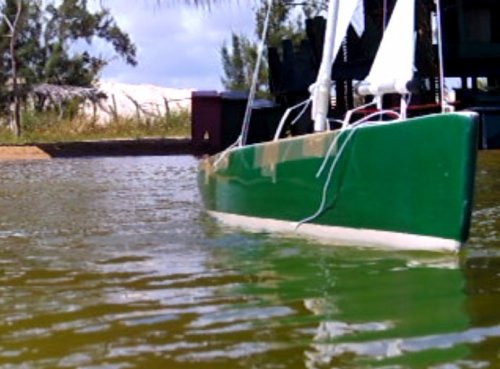

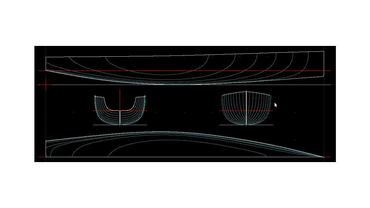

Well, my friend Ademir Nicaretta, a jurassic lover of IOM, 30 years experience in naval modeling, living in Brasilia, do a IOM Hull Depth gauge v.3R and he put my IOM there.
He say me: "Your IOM dont have depth!". I smile and went to see what he is doing, and I see really that by the gauge my depth was minimal. Seeing well I see that, how my stem have 2 cm under DWL my IOM when in the gauge have a minimum depth.
Why my stem has 2 cm in depth? Because when I do the design I d'ont wanted my stem out of water when in strong winds. like Pikanto and Lintel. Less DWL Lenght, less velocity.
Yesterday when I was looking for my new design and seeing to the transom that have a little elevation from DWL, ocurred me that if I put my future IOM design in the gauge my virtual depth will be more diferent yet.
Why my transom is above DWL? Because the dynamic wave formation, to minimize drag and the cut in the boundary layer.
The gauge is to measure the depth or for what?
